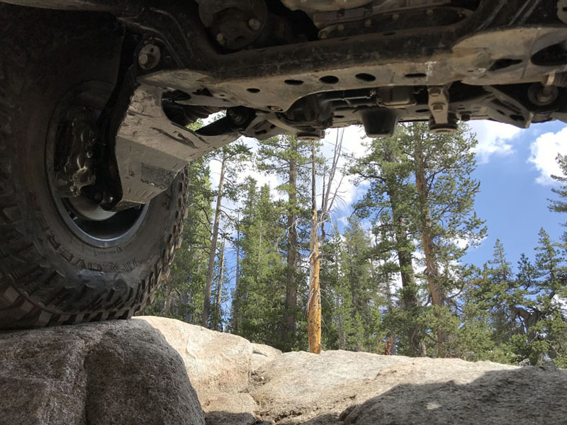

Q: Are factory and aftermarket skid plates compatible with RCLT HD? A: As far as we know all skid plates, stock and aftermarket, are compatible with RCLT HD. Update 8/3/2022: Skid plates that utilize the M12 bolt hole in front of the factory steering rack’s LH frame mount may require modification to work.

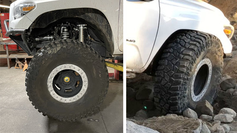

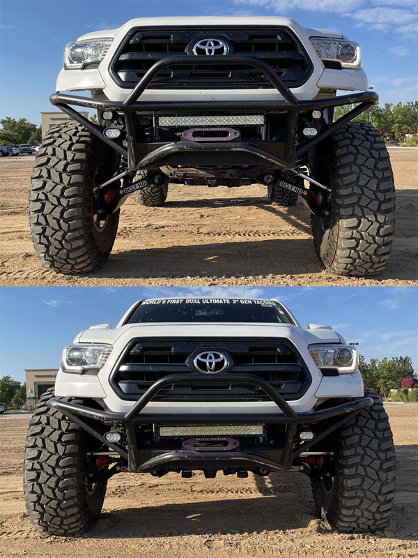

Q: Do you have to relocate headlights in order to run 40″ tires? A: When I allowed my TacomaWorld forum thread to get hijacked last year, some user who has never ran a LT with 40s claimed I relocated my headlights in order for this to work. He is mistaken as I run my 8″ Radflo shocks (p/n 6CT-001-5A) to full compression and all my components are in their stock location, including headlights and battery.
Q: How is the ground clearance comparison fair when Nate’s Tacoma is on jack-stands? A: Nate can easily set his ride height to match what’s shown, and also the Jeep is on taller 39″ tires while the Taco is only on 38s!!
Q: Will Nate’s truck be at the 2022 KOH? A: Hopefully yes and come see it & meet Nate in person at our Marlin Crawler booth!
Q: How did Mike like Nate’s coffee? A: It was delicious and was served in a stainless tumbler with “Dirt Lifestyle” logo!

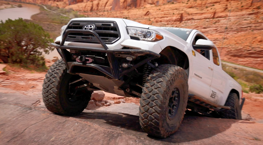

RCLT HD with 40×13.5″ tires under a 2016 V6 Toyota Tacoma
More than 70K miles of testing with 40s and zero steering, axle, or differential failures

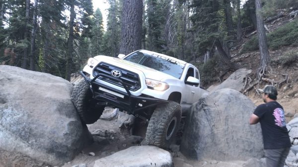

RCLT HD has come a long way since we began testing and building in 2018. RCLT HD customers have successfully ran these trails plus many others country-wide, including trails in Japan.
Below is a list of trails we’ve tested RCLT HD with up to 40″ tires with zero failures during prototyping:
