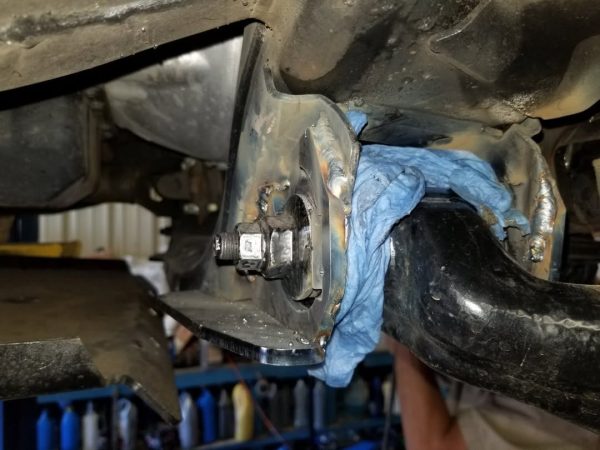

Here's how one customer did it:
Step 1: Prep the frame — wire brush off grease, grime, and factory paint where you'll be welding.
Step 2: Use anti-spatter spray and a weld blanket to protect sensitive components (CV boots, brake lines, ABS wiring, etc).
Step 3: Wrap water-soaked rags around the LCA bushings to keep them cool.
Step 4: Tack weld parts into position and then weld one edge at a time, rotating around to other up-rights to manage heat. Keep rags saturated before resuming each weld.
Step 5: Once the welds cool (~20 min), spray paint to seal against corrosion — and that's it!
You've just transformed your paper-thin 0.10" (2.6mm) cam tabs into armored uprights nearly 2.0" thick, with no re-alignment needed, no parts removed, and no extra labor costs.

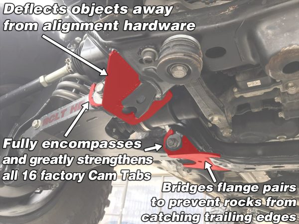

And the benefits go beyond strength:
- Converts single-shear control arm mount to double-shear, strengthening the IFS sub frame and protecting from trail damage
- Adds angled deflection bracing to protect alignment hardware from rock strikes
- Preserves alignment and prevents damage from underbody impacts
- Prevents sloppy alignment shops from incorrectly rotating your eccentrics upside-down and vulnerable to objects passing under your rig

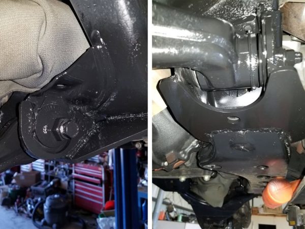

Below is another customer example, also showing ample clearance around an aftermarket skid plate:
Want to go the full route?
The full install method involves removing both lower control arms, giving you better access for full coverage spray painting and maximum corrosion protection. Many customers choose to install our kit now using the quick method above, then revisit the paintwork later during future suspension upgrades.
Either way, you've just made a massive upgrade to your vehicle's alignment integrity, safety, and driving performance — for life.

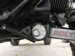

For 1995-04 Tacomas and 1996-2002 4Runners, it is a bit different due to the frame and skid plate design which prevented us from adding the lower double-shear plating, but the kit is even easier to install as it only involves just the uprights like this:
